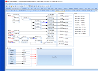

Hi all:
    I am now working on chnaging the speed of EMIF bus which from 75MHz to 100MHz. Through the halcogen, I have successfully changed the frequency of EMIF into 100MHz and test the frequency through oscilloscope.
    Then I want to use RTI module to act like “time stamp" to test copying data from SRAM to SDRAM. In this case I also reconfigure the rti module which maintain the 5Mhz. The test code is below:

In my mapclocks, the HCLK is 100mhz, VCLK1=VCLK2=VCL3=100Mhz.

The result is confused for me. In main function, the result of "timedely" equal to 2000 in 100Mhz however the result of "timedely" equal to 1500 in 75Mhz. which means the process of copying in 75M is faster than 100M.
Are there anything wrong in my configuration(clockmap,rti)?
