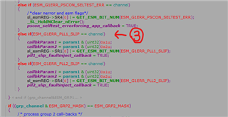

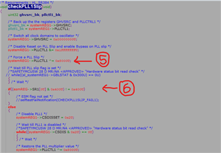

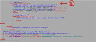

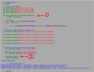

Hello, team.
According to Safety Manual (SPNU575A), I implemented PLL1 Slip detector (CLK2).
I copied checkPLL1Slip() anc checkPLL2Slip() from TI Sample code in demo_app (..\SafeTI Diagnostic Library\2.4.0\demo_app\common\source\faultInject.c).
However, System halt occurs in checkPLL1Slip().
checkPLL2Slip() is not problem.
It's my setupPLL() code.

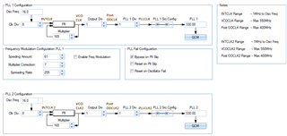

My board is Custom board. (Not evaluation board)
Below is PLL Setting in Halcogen.
Please let me know where the wrong is.
