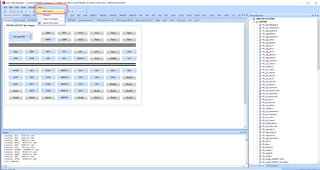

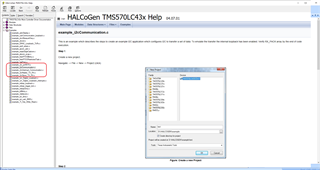

    The software drivers for i2c will be generated from HALCoGen. And if you need any reference examples then do the following steps,
    If you were already downloaded HALCoGen, then please go to the Help Topics as highlighted below
    Now in Examples section you could see the several i2c examples:
    Here they will give step by step procedure for generation of i2c driver and with example application project.
