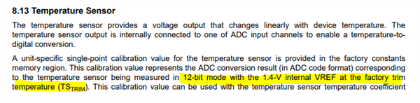

    To the best of my knowledge, there hasn't been any issues reported with temperature calibration constants.  I did find in the TRM that the factory constants are derived using 1.4vref.  I noticed in your description that you are using 2.5vref?
    measured 12-bit value 1058 (at 2,5V reference value),
  • Yes, for the measurement of the ADC channels (including channel 11 for the temperature sensor) the 2.5Vref is used. I use the formulas from the reference manual. The parameters Factory time temperature (30°C) and Temperature coefficient (-1,75mV/°C) are from the datasheet.
    The calculating of the Vtrim value is done with the 1.4Vref value. => Vtrim = 1.4V/4096*(TEMP_SENSE0.DATA-0.5)
    TEMP_SENSE0.DATA = 392 => Vtrim = 0.133V
    Vsample = (2.5Vref/4096)*(1058-0.5) = 0.645V
    Tsample = (1/(-0,00175 V/°C)) * (0.645V - 0.133V) + 30°C = -263°C
    Hint: The example from the reference manual use the value:
    TEMP_SENSE0.DATA = 1857 (ADC result code based on 12-bit mode and a 1.4-V reference)
    If I use this value (1857) for the calculation, then I get 23°C.
    This value is in the expected range, but not the previous value, which use the trim value from the chip.

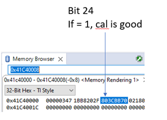

  • Hi Bernhard,
    It is bit 24 of the device id at location 0x41C40008.
    There is an errata in the works and the work around will be to perform a single point calibration on those units where bit 24 = 0.
  • The bit is cleared at our controllers. For now, knowing that there is an errata is enough.
  • Hi Bernhard,
    Ok.  You can see from my picture above mine is as well.  If that answers your question, I'll go ahead and mark this post resolved.
