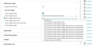

I am trying to figure out how to trigger SOC on ADC 4 times per period from one ePWM.
I mean, if I have 1000 HZ frequency, I need to trigger SOC every 250 us (period / 4)
Is it possible?

Hi Oleg,
yes. this is possible, from the EPWM's Event Trigger Submodule, we have the SOCA/B trigger enable/source selection. the following is a snapshot from the syscfg where this can be configured. select the mix event, then mixevent source shows up. now any 4 events that match the timing and can be used for trigger generation. Hope this helps.

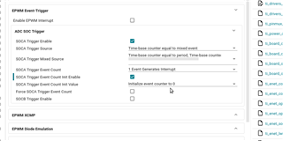

Note: further configurations that "1 event generates interrupt", "count int to 0" shown in the second picture below are alos required.
