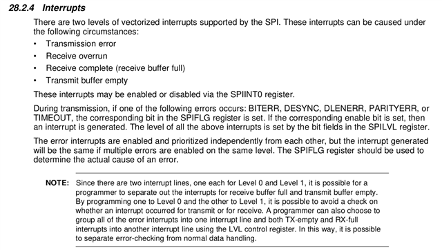

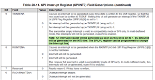

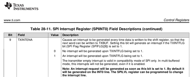

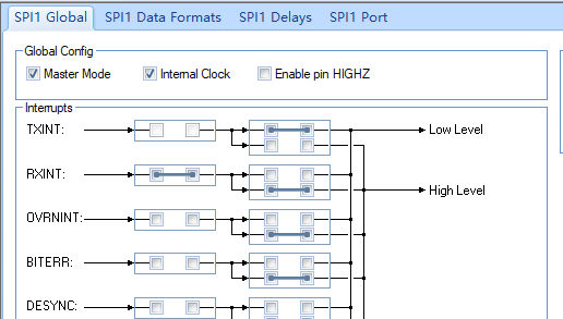

Hi Hongbo,
According to above data, the TXINT is generated as soon as it is enabled. So that means the TXINT bit should need to be SET only after all the initializations are completed right?
If we SET this bit during initializations, this will create interrupt immediately without any proper SPI initializations and this makes the SPI behavior unpredictable. And also, after initializations completed, we don't get TXINT again as we already processed the TXINT in initializations itself2.
Due to these reasons, they didn't provide chance to enable TXINT in HALCoGen. It should always need to be enabled after initializations.
