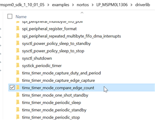

  • Hi Kenley,
    In fact, you can find an example code about edge count in the SDK.
    Maybe customer can refer to it first and evaluate the function easily.
    Yuhao
