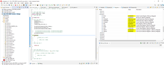

We are configuring the DCC module to use counter1 as reference for measuring the clock source of counter0. The DCC freezes the counters when the counter1 reaches zero.
The test is working, but sometimes the the status turns to 1 when counter1 is 1 instead of 0. Any thoughts about that?
Marcio

  • Hi Jagadish,
    It seems a different issue because we are setting DCC1 to stop when the counter 1 reaches 0, as described in "Freezing Counters when Counter1 Reaches Zero:" section 15.2.2 of SPNU562A–March 2018.
    In the picture we can see the Stat=1 (fail) Cnt0 != 0 and Cnt1=1. I would expect to see Stat=2 (done) Cnt0 != 0 and Cnt1=0 .
    Marcio.

    Here is an update from my side.
    I tested with same settings as yours on my RM57L853 Launchpad
    Here is my tested code:
    DCC_TEST_RM57.zip
    And in this code i also generated 1MHZ on board with ETPWM1A, and i connected same signal to the EXTCLKIN1 and used it for DCC.
    And here is the debug result:
    I tested almost 20 times and i got the same result and i couldn't see Cnt1 value as "1".
    So, i want to check with below things with you:
    1. How frequently you are getting Cnt1 value as 1, out of how many times you are getting this behavior?
    2. From where you are applying 1MHz signal?
    3. Can you please test my code and let me know the result; you just need to short the D9 (ePWM1A) pin of the controller with B5 (EXTCLKIN1).
    Thanks & regards,
    Jagadish.
  • Thanks for you response Jagadish.
    Approximately 1 time every 30s the status turns to 1 when counter1 is 1 instead of 0. We left the test running repeatedly until the error happens.
    EXTCLKIN1 is an independent chrystal oscillator of a 1MHz. OSCIN is 16MHz chrystal .
    Is the ETPWM1A output synchronised with the OSCIN?
    Ok. I´ll do it and return the result to you.
    Thanks and regards,
    Marcio.
    I ran tests in the LauchPad board connecting EXTCLKIN1 to ePWM1A and also connecting EXTCLKIN1 to a waveform generator.
    First I ran your program. It only compares EXTCLKIN1 and OSCIN once.
    Then I´ve modified the program to repeat the comparison indefinitely.
    I could not reproduce the same problem I saw with my application in our board.
    Thank you very much for the support.
    Marcio

  • Hello Jagadish,
    There are not too many differences. The DCC configuration parameters are the same. Your dccInit also configures DCC2 and the seeds are configured after. My application does not configure DCC2. Your program stay in a loop waiting for the result. My application starts the test, does a lot of other things (including treating other perifherals), which take more time than the test itself, and then returns to check the test result.
    I will move the test code to my application and run it on our board, and post the result on this thread. The hardware team is also involved to check the EXTCLKIN1 input.
    Thanks and regards,
    Marcio.
  • Hi Marcio,
    I would say this is a good idea.
    Thanks & regards,
    Jagadish.
