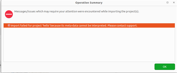

  • when i am importing hello project on linux ccs i am getting below error
  • How did you import the project? Import does not mean a simple copy folder. The import will also set up the CCS settings for the project. I just wanted you know that.
    Show your project folder. You should see something like below after you import the project.
  • Dear first time i made mistake but now i can able to build hello project as well as can related file you suggested.
