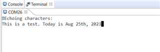

    I'm running the same uartecho example and I can't see any abort generated due to Semaphore_pend in the UARTTiva.c file.  I'm not sure if you had modified the example. Can you confirm that if you run the stock example as is, it will work for you? See my COM port display. I type in some text and no problem running and I do not encountered any abort.
