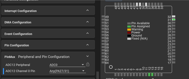

HI everybody ,
I m willing to use 28 pin device .   Now I want to use A0_12   ( which is  PA14  and in 28 pin  package is pin  17 )   but I m not able to do it
actually I m not able also in 64 pins  , so something is wrong on my side .
please could you kindly give me  proper step by step instruction on how to do it in SYSCFG   : so how to have the pin assigned ( so if I select a CH how to have proper pin involed selected )
thank you very much
BR
Carlo

  • Hi Dylan
    thank you for your prompt reply but I did your setting and problem is tstill here :  have  a  look to the chip and pin 7 is NOT reserved to ADC0-12 as expected ( I m using your config exactly )  see picture hereunder  ( MEM0  is showing PA14   as needed  but not on chip view even if compiled ) .
    you see  you are still using PA27 ...  how can I get the ADC0-12 on the pin 7 as expected and needed ? Am i wrong ?
    it seems  ADC12-0 is not taken in account in the  pinmux and setting  ( same if you look at SYSFGC code )
    coudl you kindly check and share a working project  so to kindly highlight me my error ?
    thank you
    BR
    Carlo
  • Carlo,
    My apologies, I've looked further into this and the issue here is with the sysconfig code. In its current state, sysconfig won't show PA14 as reserved for ADC0_12 even if it is set correctly.
    Despite this, the code generated by sysconfig should still give you the correct behavior. I have used these settings on my own device and verified it using a waveform generator and viewing the ADC conversion results.
    This is an issue with sysconfig that will be fixed soon, but until then you can still achieve the correct behavior in the device.
