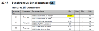

    Secondly, is it possible to recieve the data from encoder at 2.5MBPS
    Shouldn't be a problem from MCU hardware point of view. SPI can operate up to 60Mhz. UART can operate up to 7.5Mbps in regular mode.
  • Thanks Charles, this information confirms that the controller is all set for this conversion, but  My code is not working, the data is not transmitted.
