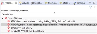

I've made a program for blinking an LED on the TMS570LS1224 launchpad in CCS 11.0. I've generated the .het driver code from HALCoGen and edited them in CCS. But I'm getting these errors.
This is the program in the "sys_main.c" file,
Can you explain me what these errors mean? And how do I solve them?
