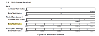

i´m working with TMS750LS1224 hercules launchpad, and i would like to know if is there a function like HAL_Dalay(ms) that can be used?
And if exist, this work when using the freeRTOS?
Thanks!

    Actually i tested this function using 220Mhz CPU clock(GCLK) with argument of 10000 cycles i passed
    Actually, based on above values, the delay expected should be (10000/220Mhz) 45.45uS right but i got the delay of 160us. Which is because of the wait cycles of the flash, as you can see the below pic the wait states are not zero for flash when clock is 220Mhz
    It is 3 for data and 1 for address.
    And when i changed input operand value to the 1000 instead of 10000 then i got the 16us. So, my suggestion to use this function is just calculate practical delay with some high value and then scale it down to the required value.
