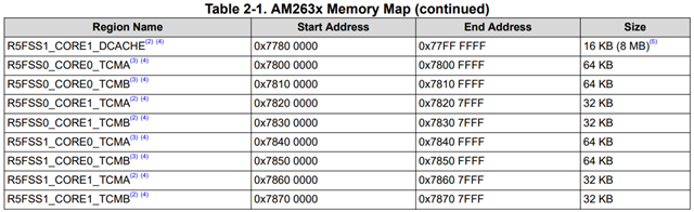

1. I understand initializing TCMA with functions like SOC_rcmStartMemInitTCMA. So how do I write data to TCMA after initialization? I understand that TCMA can only be accessed by each core. Is there another way?

    The RAM memory can be initialized by using the dedicated auto-initialization hardware. The RAM data memory locations will be initialized to zeros and the corresponding ECC memory is initialized to the correct ECC value for zero. You can write the data directly to the TCMA locations, and no special procedure (for example used for NOR flash) is required. To write data to other core's TCMA, please use the correct memory addresses defined in Memory Map table in TRM. Those memory regions are used by each CPU core to access the TCM memory space of other CPU cores.

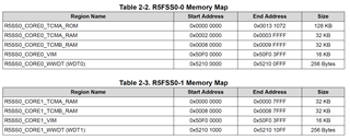

    1. Currently, R5FSS0 operates in Lock-step mode and F5FSS1 operates in Dual-core mode.
    In this case, is it correct that the TCM area allocated to R5FSS0_1 is all used by R5FSS0_0?
    And R5SS0_CORE0_TCMA_ROM overlaps the area. How should I understand it?
    Please explain the TCM area of R5FSS0 in lock-step mode.

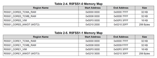

    - The area below is Dual-core mode, so it makes sense. (R5FSS1)
    - Please explain how the area below is actually allocated in Lock-step mode and how the overlapping part with R5SS0_CORE0_TCMA_ROM is handled.

    Yes, you are correct.
    In Dual Core mode: CORE0 and CORE1 have 64KB of TCM: ( 32KB TCMA  + 32KB TCMB)
    In Lockstep mode: CORE0 has 128KB of TCM. The 64KB TCMA is from 0x00000000 to 0x00100000, or from 0x00020000 to 0x00030000. The 64KB TCMB is from 0x00080000 to 0x00090000. After the boot sequence is complete, both TCMA_ROM and TCMA_RAM are mapped to  a same physical memory (TCMA RAM).
    During boot, the ROM code is copied to TCMA_ROM and executed from TCMA_ROM.
    After boot sequence is complete, both TCMA_ROM and TCMA_RAM are mapped to  a same physical memory (TCMA RAM). When you write data to 0x00000000, the data is  written to 0x00020000 too.
