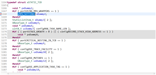

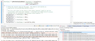

We are facing some compilation error while enabling portUSING_MPU_WRAPPERS in mpu_wrappers.h file. Some structure types are not defined any where and some function prototypes are also miss matched.

    We are planning to protect the whole kernel code and we are planning to use trusted task feature and protected system call(supervisory system call) these features will be enabled only MPU wrappers.
    And safety feature are mandatory for our project and this was throwing compilation error while compiling.
    kindly Can you verify from your side, it was present the Ti official SDK release.
  • In MCU+ SDK the MPU settings are defined agnostic to the kernel outside of the FreeRTOS port.
    It's not clear (to me) why this is a reason for the missing definition. Surely for a specific port nothing should be agnostic and everything should be defined for the target.
    I downloaded FreeRTOS. There are definitions for xMPU_SETTINGS in many of the ports including GCC:
    \FreeRTOS-Kernel\portable\GCC\ARM_CM4_MPU\portmacro.h
    But it is not in this file or any other CCS file:
    \FreeRTOS-Kernel\portable\CCS\ARM_CM4F\portmacro.h
    It indicates that perhaps MPU is yet to be developed for CCS/TI processors.
  • yes, true, we can find definition for CM4, but we were not able to find the definition R5F core.
