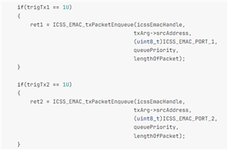

I am facing a problem where on the evaluation board there is two ethernet ports (eth1 and eth2), when only one port has link then whenever we want to send a packet at bootup it will try to send on both port (which is normal since the mac table is not yet build up) but then 1 port has no link so the function ICSS_EMAC_txPacketEnqueue() returns ICSS_EMAC_ERR_TX_NO_LINK which is expected.
Here is the code in the SDK I am talking about :
So in this case ret1 or ret2 is then equal to ICSS_EMAC_ERR_TX_NO_LINK
The problem is then at the end of the ICSS_EMAC_txPacket() function we return "return ((ret2 << 16) | (ret1));" so if ret1 or ret2 is not 0 then the upper layer sees as if the send of the packet failed.

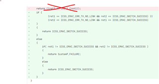

To fix this I have made this change:
I would like to have a feedback on this, would you have a proper fix on your side ? Or maybe you consider the fix I made as the good one ?

  • Hi Yanvyes,
    This is fixed in Industrial Communications SDK 9.0. Copying the updated code for reference.
    The intend is to get the Port1 status in 16 bit (LSBs) and Port2 in the other.Please confirm this will solve the issue you are seeing

    Are the ret1 and ret2 still initialized to SystemP_FAILURE per default ? If yes then it will still cause a problem.
    And the change you have applied is in the else case of the "if (portNumber == ICSS_EMAC_PORT_0)    /* special case to use MAC learning */", but for us the problem appears inside the if case.
    I understand the intent to get the two error codes in only one, but can we cannot set an error in case of one ICSS_EMAC_ERR_TX_NO_LINK. Taking ICSS_EMAC_ERR_TX_NO_LINK as an error force us to have both port connected, when it should be working when only one port is connected.
