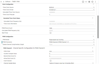

MSPM0G3507: With channel 0,1,2 only enabled in sysconfig, CCACT of channel 2 is automatically configured differently from Channel 0 and 1.
Part Number: MSPM0G3507
Although only 0 1 2 channels enabled, the  .isTimerWithFourCC = true in DL_TimerA_PWMConfig is automatically set as true,
which results in
SYSCFG_DL_LED_RGB_init  --> DL_TimerA_initPWMMode --> true == config->isTimerWithFourCC -->
case DL_TIMER_PWM_MODE_EDGE_ALIGN_UP:
DL_Timer_setCaptureCompareAction(gptimer, (DL_TIMER_CC_LACT_CCP_LOW | DL_TIMER_CC_CUACT_CCP_HIGH), DL_TIMER_CC_2_INDEX);
 is executed.
I have to manually re-config CCACT of channel 2 as DL_TIMER_CC_LACT_DISABLED | DL_TIMER_CC_CUACT_CCP_LOW | DL_TIMER_CC_ZACT_CCP_HIGH (same as channel 0 and 1).
Any clue to disable (isTimerWithFourCC = true) by sysconfig setting?
