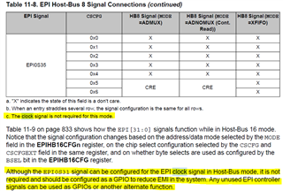

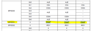

    In Asynchronous Host mode, EPICLK can be brought out although typically it is not used by the external devices because of the nature of asynchronous protocol which does not require the clock. See datasheet description. The asynchronous interface signals are generated wrt EPICLK.

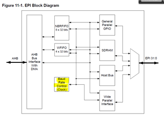

    What do you mean the System Clock is an external clock? EPICLK is an internally generated clock. EPI module does not take any externally (off-chip) generated clock as a reference clock.

    Perhaps I'm mistaken by what you mean by external clock source. If you refer to external clock source (relative to the overall MCU) as a clock source that is outside the MCU device then there is no such clock source. The MCU system clock source can only come from either PLL or one of the oscillators (e.g MOSC, PIOSC, internal 30khz OSC or an external 32.768Khz OSC). If you mean the external clock source (relative to the EPI module) as the reference clock for the EPI module, then yes. The EPI module uses the internally generated system clock to divide down for EPICLK generation.

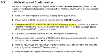

  • Please note of the below limitation if you are using a crystal. You can only achieve 30.72Mhz (not sure why this particular frequency for EPICLK) if you feed the MCU with a single-ended clock.
    Main Oscillator (MOSC). The main oscillator provides a frequency-accurate clock source by
    one of two means: an external single-ended clock source is connected to the OSC0 input pin, or
    an external crystal is connected across the OSC0 input and OSC1 output pins. If the PLL is being
    used, the crystal value can be any frequency between 5 MHz to 25 MHz (inclusive). Refer to
    Table 5-7 on page 238 for recommended crystal values and PLL register programming. If the PLL
    is not being used, the crystal may be any one of the supported frequencies between 4 MHz to
    25 MHz. The single-ended clock source range is from DC through the specified speed of the
    microcontroller.

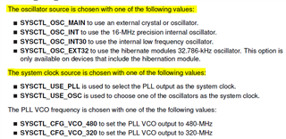

      The SysCtlClockFreqSet() API is not designed to support single-ended input clock. The arguments you are passing right now will cause SysCtlClockFreqSet() into thinking that there is no oscillator source and hence pick PIOSC (16Mhz) by default.
    Please try to fool the API into thinking it is a 25Mhz MOSC with the below call although externally you are driving a single-ended clock input with OSC1 left open.
      SysCtlClockFreqSet((SYSCTL_XTAL_25MHZ | SYSCTL_OSC_MAIN | SYSCTL_USE_OSC), 25000000);

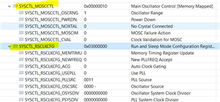

      Please show the settings of the below registers. You may need to manually write to some of the fields to get it working.
  • (gdb) x 0x400FE0B0
    0x400fe0b0: 0x03000000
    (gdb) x 0x400FE07C
    0x400fe07c: 0x00000030
    The EPI clock out is still 16Mhz
  • OK, I manually set
    (gdb) set {int32_t}0x400fe0b0 = 0x03300000
    (gdb) x 0x400FE0B0
    0x400fe0b0: 0x03300000
    After the call and the clock is output correctly on the EPI again. Don't know why It was working before...
