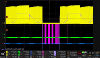

Customer side has an issue regarding to EPWM2 PWM output. In their design, they use EPWM1 as sync source (EPWM1 CTR=ZRO), and EPWM2/EPWM3's PRD shadow load event is this sync signal and PRD is also linked to EPWM1's PRD. EPWM1/2/3 will have frequency/period suddenly change and slowly change (i.e. 40kHz suddenly change to 60kHz, and 60kHz slowly change to 40kHz). And the EPWM2's configuration codes are as follow. Notes the action qualifications are CMPB-Down pull-up and Zero pull-down.
During suddenly changing the frequency, i.e. 40kHz -> 60kHz, sometimes the PWM2' output will not change. A 25us background task read out the CTR and PRD value of EPWM2, and if the CTR is larger than PRD, one GPIO will be pull low. As shown in following figure (the purple signal is the GPIO), when the PWM output not change, detected that the CTR value is larger than the configured PRD value.  And in the figure there is an measuring signal of the frequency for the PWM output (yellow signal is PWM2's B output, and the measuring frequency is over the yellow signal). As you can see, the issue is happened when suddenly changing the frequency from 40kHz to 60kHz, not each time but accidentally. The PWM output missing means that the CTR = CMPB-Down event missing from the AQ configuration
We tried a lot things, such as disable the phase-shift, etc., but not work. Finally, we found that if during suddenly changing PRD of the PWM2, we give a larger CMPB value (>100, for example) firstly, and then step-by-step reducing the CMPB value to the expected small value, the above issue can be avoid:

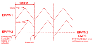

I think the issue maybe caused by EPWM2 PRD shadow load action sometimes not work and CTR-CMPB down event missing and also CTR value will larger that the configured PRD value (we tried using CTR=CMPB-up event to pull up the output, and it works). The concept is shown in following figure:
So questions are why PRD shadow load not action, and why if we configure a larger CMPB value this issue can be avoided.

    Sorry for the delay in reply but there was a lot of detail here so I wanted to take time to carefully unravel it. I am not certain I have a full understanding, but I will outline what I believe you are doing and where I think the issue is with the understanding of how the module works. Please let me know if I am mistaken at any point with my understanding of your setup.
    Setup:
    • EPWM1 is used as the Source of AQ Trigger Events T1/T2 for EPWM2/3.
    • EPWM1 counts down and when its zero, it shadow loads from the shadow register to active register
    • If this occurs when the CTR value is greater than the new PRD value being loaded from the shadow register, then you do not observe a change in PWM2 output
    • Your expectation is that when a PRD is loaded that makes CTR > PRD, the CTR = CMPB-Down event would occur.
    If I have that all right...
    My understanding of how the device is expected to operate:
    • The EPWM is configured for Counter Mode Up Down to start
    • The EPWM is configured for Counter Mode Up after sync
    • Because the issue occurs following a shadow load that is a sync event, when the issue occurs, the EPWM is operating in a state where it is in Up-Count Mode
    • Because the new PRD has been loaded when CTR is larger, it is not possible for a CTR = PRD Match to occur
    • Therefore no AQ events are triggered and the output does not change as expected
    • Lastly, when configuring with a larger CMPB value, that created a situation where the CTR can hit the CTR = CMPA event which when counting up should prompt a Low action from the EPWM
    One piece I don't understand is why there is a notion that the CTR = CMPB-Down event would occur. I'm not following the logic towards that expectation given the configuration explained.
