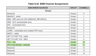

I am a bit confused on how to catch and signal failures detected by LPOCLKDET and the PLL slip detector.
Besides reading the Global Status Register (GLBSTAT), do they trigger an ESM interrupt?
If yes, how to configure the LPOCLKDET and the PLL slip detector to generate an ESM interrupt? Do you have an example?
    Yes, they can trigger the ESM interrupt.
    If you refer the datasheet, then you can find them in ESM group-1 channels.
    And the Group-1 ESM channels have a configurable interrupt generation

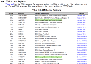

    So, you just need to enable the corresponding bit in the interrupt enable register.
    So, you have to set the following bits.

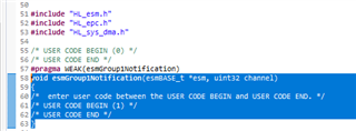

    So, you can just call the above function with corresponding channel number to enable the interrupt generation.
    once you did that then, whenever the corresponding interrupt occurs then the ESM module will notify the interrupt using the function "esmGroup1Notification"
    So, you can add your required definition in the esmGroup1Notification function.
