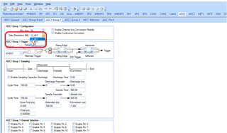

    As you can see, the ADC can be operated in 8bit, 10bit or 12bit resolutions right, so that means if you operated ADC in 8 bit resolution with 3.3v ref then when you connected 3.3v to ADC pin then you should get 0xFF (255) value.
    or else if you operate ADC in 10 bit resolution with 3.3v ref then you should get 0x3FF (1023) value, if you connected 3.3v input.
    or else if you operate ADC in 12 bit resolution with 3.3v ref then you should get 0xFFF (4095) value, if you connected 3.3v input.

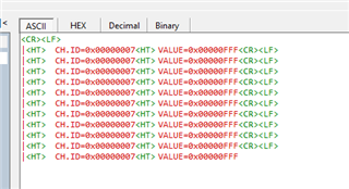

    For example, as you can see below pic when i operated ADC in 12 bit resolution with 3.3v ref and 3.3v input.
    Please make sure you are doing right setup.

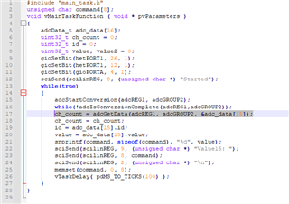

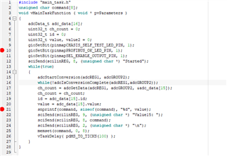

    I have added code.
    I'm using the IAR Compiler. I hope this is not a problem for you.
    Few things i am not clear with your code.
    The main thing is below:
    1. You declared "adc_data" array with 16
    That means your array will start from the adc_data[0] and will end at adc_data[15] right?
    And you selected two channels right ADC_8 and ADC_15.
    If you pass the last address of the array i.e. adc_data[15] address to the function "adcGetData", where will be the second channel data will be stored?
    The first channel will be stored in adc_data[15] and then for second channel the array will get over flowed right?
    Why don't you pass the starting address to the function i.e. &adc_data[0]? If you do that the channel 8 data will  be stored at adc_data[0] and channel 15 data will be store at adc_data[1]

    1) Yes adcData[16] was an attempt to keep adc data between 0 and 16.
    Yes, I activated two channels as channels via Halcogen.

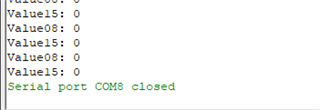

    Yes, I did as you said. I was able to see zero data on two separate channels. Thank you.
    I skipped the step where the data will be transferred to the next element.

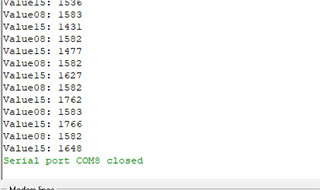

    The problem seems to be solved, but at the moment, channels 8 and 15 are affected by each other.
    So it is like this:
    When channel 8 and channel 15 are connected to zero, both values are zero.
    When Channel 8 is connected to GND channel 15 3.3v, I see a value between 800 and 300 for Channel 15.
    When channel 8 and channel 15 are connected to 3.3v, it returns a value between 1500-1800 for channel 15 and channel 8.
    The problem here is that I cannot get the same value consistently.
    Is it due to voltage drop or some other reason?

  • Hi Ali,
    These results are not expected.
    I mean as we are operating in 12-bit resolution, so if we connect 3.3v then the result should be close to the 4095.

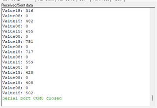

  • Hi again,
    1. What is the board you are using? Is it TI specific or custom board?
    I'm using the Texas Instruments Hercules board.
    Why don't you try simple bare-metal code without RTOS first? Your ADC code looks fine for me but may be due to RTOS scheduler or with any other peripherals in RTOS it might affect right? so first just try ADC alone on simple bare-metal code without RTOS?
    It's nice idea. I updated the code and try again. But the results are same. (

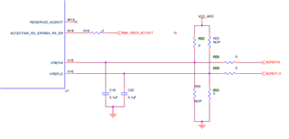

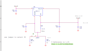

    After that I changed my ADREFHI pin to external 3.3 Pin and I connected AD1_15 to this external 3.3V bus.
    The results are below:
    It's closer to 4095 than it used to be.
    I think the problem in the analog references and input voltage. Am I right?
    Thanks& Best regards
  • Hi Ali,
    Yes, you are right, it is due to analog reference voltage.
    The reference voltage is depends on the R1x and R2x. If J8 is not mounted on your board then the reference voltage will be 5v. If J8 connected then the reference voltage will becomes 3V.
    If you connect external 3.3v to the ADREFHI, then you should remove the R22 and R31 for more accurate results.

  • Ohh that nice information to me. J8 jumper is removed before and I didn't see.
    I didn't know that before. Thank you
    It is done right now. I'm receiving 4095.
    Thank you
