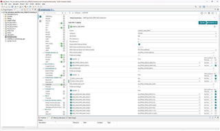

We are developing a new board that is using ICSSG0 (instead of ICSSG1).
To test it, I changed ICSSG1 to IGSSG0 in .syscfg file but I am not able to ping it.
Do we need to change the PRU firmware to make it working or there is something else I missed?

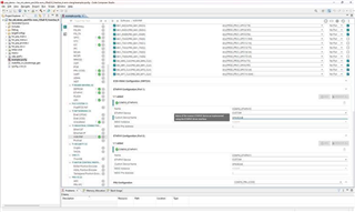

    We are using a DP83826E. I tested by using the loopback Far-End (Reverse) Loopback feature and I see packets.
    The PHY used returns a link up.
    My application builds correctly.
    The configuration of the PHYs is made by using ETHPHY Device "CUSTOM"; Custom Device Name "DP83826E" in syscfg.

    Here is the generated .syscfg file

    The changes that were implemented to support the custom board were:
    • ICSS instance (from 1 to 0)
    • PHY addresses changed to [0; 2]
    • EDC_LATCH_IN0 disabled
    • EDC_SYNC_OUT0 disabled
    • Changed CONFIG_ETHPHY0 to CUSTOM (Custom Device Name set to DP83826E)
    • Changed CONFIG_ETHPHY1 to CUSTOM (Custom Device Name set to DP83826E)
    • Enable “CONFIG_ICSS_EMAC0 Learning Enable”
