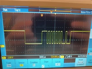

    Here is the oscilloscope capture of one LIN frame generated by the following code from the SDK "External Lin Example"
    The only change that I made is to replace for-loop with while forever loop with "i=1" in order to have only one frame to be investigated.
    As I have indicated the header part seems to be complete but there is no response field sent.
    Saman

  • Hi Aakash,
    I have used lin_external.c code in one thread in my own code. But, again it only sends the header part not the response field !!!! even when I check the LIN in default configuration.
    I also used the attached above lin_external code but it does not work.
    I guess that there should be some adjustment in SDK to have it completely fixed.
    Would you give me any advise regarding that please?
    Saman
  • Hi ,
    Did you also update the lin.c.xdt at source/drivers/.meta/lin/templates/lin.c.xdt ? This will impact the generated files via syscfg.
    Aakash
  • Yes I have updated the file lin.c.xdt
  • Hi ,
    You will find the generated file to create a different driver_init and with the updated lin_external file, this works with all the combinations in the sysconfig.
    Hope it helps.
    Aakash
  • Hi Aakash,
    Where can I find this "driver_init"?
    BR
    Saman
  • Hi Aakash,
    The Sysconfig/SDK behaves confusing.
    When I change LIN_TXD/RXD pins from (LIN1_RXD/A9,LIN1_TXD/B9) --> (UART1_RXD/L3, UART1_TXD/M3) the firmware which was working fine, again , it does not work (ONLY send "Header part").
    I have updated lin.c.xdt file and updated lin_external.c as well.
    One more point is that when I change back the TXD/RXD pins to A9/B9 then I need to power off/on the board in order to have the LIN completely working.
    otherwise it only sends the header part.
    BR
    Saman
  • Hi Aakash,
    My question is that:
    Why only changing TXD/RXD pins in SYSCONFIG impacts the LIN behavior ?
    Saman
  • Can you replicate this at your side and confirm this?
  • Hi ,
    We are not able to replicate this on our end. Please try adding a transceiver on another pads and check if the example works or not.
    Aakash
