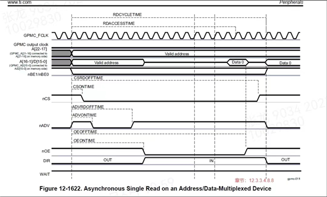

Hi Experts,
I am asking for my customer here.
They want to use AM2434-ALV GPMC to communication with FPGA here. But they want to confirm that nBEn[0-3] Pin Need to design and consider here. Due to the nBE1 Pin conflicts with FSI_TX_CLK, they also want to use FSI here. We check DS and TRM, found that there are different waveform below:
-GPMC w/nBE1-nBE0.
--GPMC w/o nBE1-nBE0.
Could you clarify the nBE1-nBE0 Pin function here? When we design GPMC, nBE1-nBE0 these Pin could be used for other function like FSI here? Thanks a lot!
