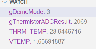

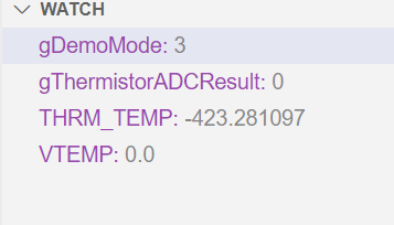

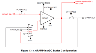

I would like to use internal OPA and GPAMP of MSPM0G3507. I tried with example code of OPA and GPAMP but it does not work for me.
I check unity gain or amplifier or Thermistor example. Please help if any specific setting of demo code.
