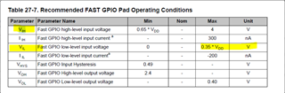

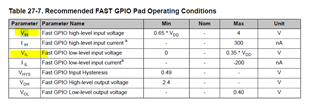

     Can you show the CLK, MOSI and MISO scope captures? is the MISO signal meeting the GPIO Vil and Vih specified in the datasheet and also the SSI Characteristics.

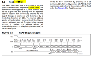

  • I've used this combination at 60MHz with no surprises. (I used High-Speed Read (0x0B).)

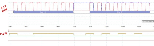

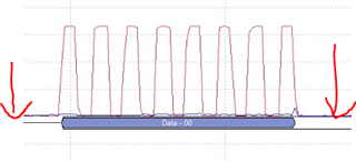

    I am attaching the capture from scope, showing 2 bytes - a CPU command and a byte from flash. This is the same byte of data we are expecting from flash: the byte which the flash chip is sending, once the byte is BF and some time later 00, while the CPU is sending the same data, the command 9F and then a dummy byte AA.
    The first picture is showing CLK (red), MISO (blue) and MOSI (digital) lines of when data from MISO is correct. The time between a clock cycle is 2.5us and MISO is at around 3V. We have the trigger on the MISO channel at 1V so we can see when the MISO is going up. The pin nCE is already low before the first clock phase, nCE goes low 280us before the clock goes up.
    On the second picture the communication show wrong data from MISO, we have a clock and the MOSI line seems ok. But we cannot see the MISO line, hence, CPU is reading 00.
    /Gergana

  • Hi Gergana,
      The two screenshots looks the same to me as far as the SPICLK and MOSI are generated. They both show CPU sending 0x9F followed by dummy 0xAA. Reading the SST26VF064B  datasheet, this is a command sequence to read out the JDEC Device ID, correct? The MISO line has proper voltage to meet the Vih and Vil requirements on the MCU side. I don't think the issue is electrical timing related but to be sure you should use a scope rather than a logic analyzer for AC timing analysis.  As you indicated, the second screenshot shows MISO is zero. I don't know what is wrong with the flash device. As far as I can tell, I don't spot anything wrong on the MCU side by looking at the waveforms. Can you repeat the same issue on another board? Are you using the #HOLD? I will suggest you look at the rest of inputs to the flash and make sure there is no noise on them. Please also contact the flash vendor. I hope they can shed some lights too.

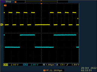

    Another thing we tried was to put the analog scope channels on the MOSI and CLK and change the scope probe for CLK to x1. The the data on MOSI was correct, the capacitance on the probe was not disturbing the data. But if we have the probe on MISO and CLK and we change the probe from 10 times to 1 time (x10 to x1) , meaning we also change the load on the CLK pin, the data the CPU is reading is wrong, or the flash is sending wrong data.

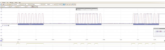

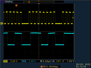

    Can you show a scope shot when you are receiving the wrong data instead of all zero's. I can't explain why zero's is received. Perhaps, the 0x9F command wasn't received by the flash device correctly and hence sending back all zeros without a valid command. When you receive 7E 4C 87 instead of BF 26 43, it looks like the master is missing the first bit. This will have something to do with the timing. Show the scope and I hope it will reveal more details.
    This is the scope screenshot.
    Channel A is the MISO, channel B is the clock, D0 is the nCE where it is low before and after we receive data. You are right, data is missing the first byte. Can it be the noise on the CLK pin that is disturbing it, I have the probe with times 1 where the capacitance is 71 pF and it is higher than having the probe times 10.
  • Here the MOSI line (D3) is added to the picture, sending the command 0x9F and sending dummy bytes.

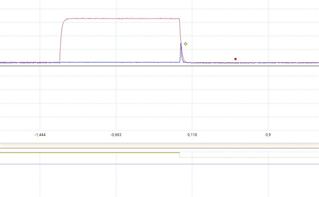

    The MISO line is low and I can notice i little upward movement at the end of the last clock cycle of the command but it continues to be low.
  • I had much higher time resolution on the scope and cpould zoom on the MISO.
    A much closer picture, where MISO is trying to go up at the last clock cycle (after the command 9F is sent by CPU) but goes low again, It goes up to 1.4V.
    And this is where we miss the first bit and we read wrong JEDEC nr. Is it something in the CPU that can cause that, this pin is input for the CPU though.
      You are in MODE0, correct? This means the MISO data is sampled on the falling edges of the SSICLK. The max Vil is 0.35*VDD which is equal to 1.15V. If MISO is at 1.4V it may not be sampled as a valid zero by the master. I have gone through the errata document and do not find any relevant errata that can explain this.

      I don't see anything wrong with your configuration. The problem is more electrical on the MISO pin rather than pin configuration. I'm a bit hesitant to suggest if adding a external pulldown resistor will make a difference on the MISO pin but you can try.

    - We have the same issue when reading from the Launchpad. Reading correct data and reading 0s.
    We have moved a flash from Launchpad and to a board which does not affect the issue any more, it is same behavior. Even when we touch by a finger the MCU pin, the error can appear.
    Can you try to introduce some extra capacitance on the CLK line by a probe or externally to see if data read from flash is affected?

  • We were trying different settings for SPI. If we change the drive strength to 10 mA for the SPI configuration, i.e. in GPIOPinTypeSSI(), we get more stable clock and do not get the error of reading 0s or wrong values of data. Would you recommend that the 10 mA is used for SPI? And can it point to some other issue in electronics as it needs to be so high?
    Hi Gergana,
    While I'm glad to see a higher drive strength somehow resolves your issue, I don't understand why as high as 10mA is needed  if the capacitive load is not huge. Earlier, you said you have a minimum distance between the MCU and the flash.  As far as I know, 2mA buffer strength which is being used by default in the GPIOPinTypeSSI is good for majority of customers. You are the first customer to require a 10mA for what I can remember. I don't really see an issue to change to 10mA but it will increase your current draw.
     I will suggest you use 10x on your probe to reduce the overall capacitive load when probing the signal on the scope. Earlier you said you measured 15pF which is within the reach of 2mA buffer at a slower rise/fall time. Using 10mA to drive a 15pF load will create a much sharper edge on rise/fall.
