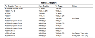

The Emulation and Trace Headers Technical Reference Manual shows that the ARM 20-PIN can be used with the XDS560v2 System Trace can be used for system trace. However, when I look at the pinout for ARM 20-PIN vs TI 20-Pin, I don't understand how these could be equivalent except for the size, additional EMU2, EMU3, and EMU4 pins, and system reset pin as mentioned in the FAQs (see my images below). Can you help me figure out pin connections for the ARM 20-PIN supporting EMU0 and EMU1?
