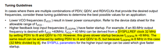

1. Incorrect pin configuration: DL_GPIO_initDigitalInput(GPIO_HFCLKIN_IOMUX); instead of DL_GPIO_initPeripheralInputFunction(GPIO_HFCLKIN_IOMUX, GPIO_HFCLKIN_IOMUX_FUNC);
2. The generated DL_SYSCTL_SYSPLLConfig structure is not matching. Is: DL_SYSCTL_SYSPLL_INPUT_FREQ_8_16_MHZ ; should be: DL_SYSCTL_SYSPLL_INPUT_FREQ_32_48_MHZ

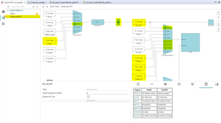

3. It is not possible to output the clock to CLK_OUT or be counted by FCC.
Clock tree is activated.
Is there any special configuration necessary to use an external clock on MSPM0G?
