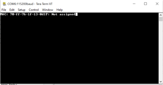

  • Hi charles
    I tried to build the project boot_demo_emac_flash, with uart prints , Iam getting the following outputs in terminal
    PFB image
    PFB code please suggest what change need to be done get the IP address  or tell the procedure how to test this demo code

        UARTprintf(
                  "MAC: %02X-%02X-%02X-%02X-%02X-%02X",
                  pui8MACAddr[0], pui8MACAddr[1], pui8MACAddr[2], pui8MACAddr[3],
                  pui8MACAddr[4], pui8MACAddr[5]);
        // Remember that we don't have an IP address yet.
        UARTprintf("IP: Not assigned");
        // Initialize the lwIP TCP/IP stack.
        lwIPInit(g_ui32SysClock, pui8MACAddr, 0, 0, 0, IPADDR_USE_DHCP);
