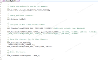

I configured the 1ms timer of TM4C according to the reference routine. The main frequency of my system is 80MHz, and the loading value of the timer is set to 80k. Every 1ms timer expires, a timer interrupt service function is entered.

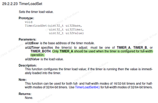

My first question is: I don’t know how the load value in the library function is calculated.

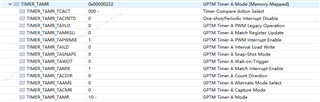

The second question is that I understand that after the timer sets a load value, if the system is counting down now, then the load value will decrease from The timer interrupt will not be triggered until 0, but the current situation I am testing is that my timer enters the interrupt before the load value reaches 0. I don’t know whether this is related to the configuration of the timer or not. what happened?

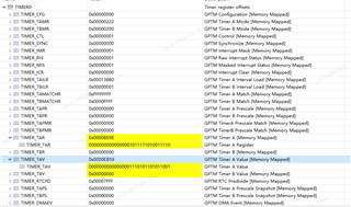

By the way, I set a breakpoint in the timer interrupt. I found that every time the timer interrupt is entered, the current count value of the corresponding timer is different. Isn't the interrupt entered when the loading value is reduced to 0?
     I don't really see a problem with your Timer module configuration. However, I don't see how you configure the system clock. Can you show how you setup for 80Mhz?

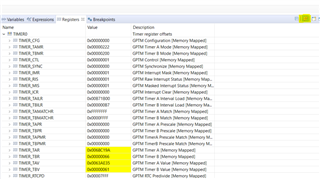

    Correct, an interrupt is not supposed to trigger until the timer timeouts when it reaches 0.
    On your register window can you enable Continuous Refresh. Do you see the TimerB counter also counting? See below and click the icon on the upper menu.
