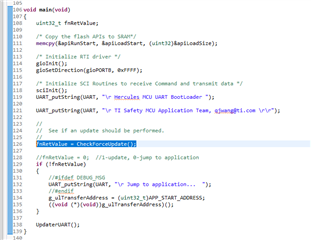

Im working on a uart bootloader on TMS570lc4357 safe Mcu but I have a problem. I download my application via bootloader. When the program jump the application problem occured. And program stay svcEntry.
Could you explain me how to solve this problem. Im thinking the problem is about safety.

    I solved problem.  But I have another problem now.
    How can I boot any mcu without hardware solution like pushing A7 button?
    İs there any way like sending a uart message for boot menu?
    Could you explain me. Thank you again.
    Talha
  • Hi Talha,
    Actually, it is also not a hardware solution you are thinking of, here in bootloader code we just configure one GIO(GIOA_7) as input and reading this pin status to verify whether any force update is required or not.
    So, it is not doing by controller hardware, it is just a provision we gave in the bootloader example code.
    It is not possible in the current example of bootloader. But you can modify the bootloader code and customize for your need.
    As you can see in bootloader code, here we are using GIOA_7 for force update, right? Instead of that you can just configure a UART and can read the data and only if some required command came from PC, then only you can go to the force update. In that way you can customize this code.
