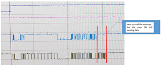

because we found the following issues:
The program code is as follows:
tem1 = (_Bool)((uDMAChannelIsEnabled(MASTER_SSI_UDMA_RX_CHANNEL))||(uDMAChannelIsEnabled(MASTER_SSI_UDMA_TX_CHANNEL)))
if((tem1 == (_Bool)false) )
uDMADisable();
It was found that the main SPI was still sending data, but the " if “ was true and the slave SPI turned off the interrupt.
As shown below, please help confirm whether there is a problem with customer`s program configuration? Please provide reference configuration. tks ~

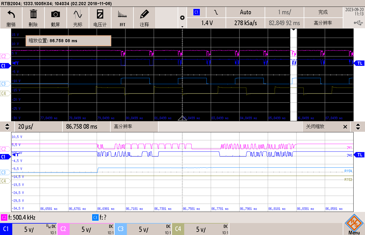

  • Hi Tsal:
     Many tks for the comments.
     today i have a visit with customer to dig out more details about this issue.
     i think there is a mistake for the previous description.

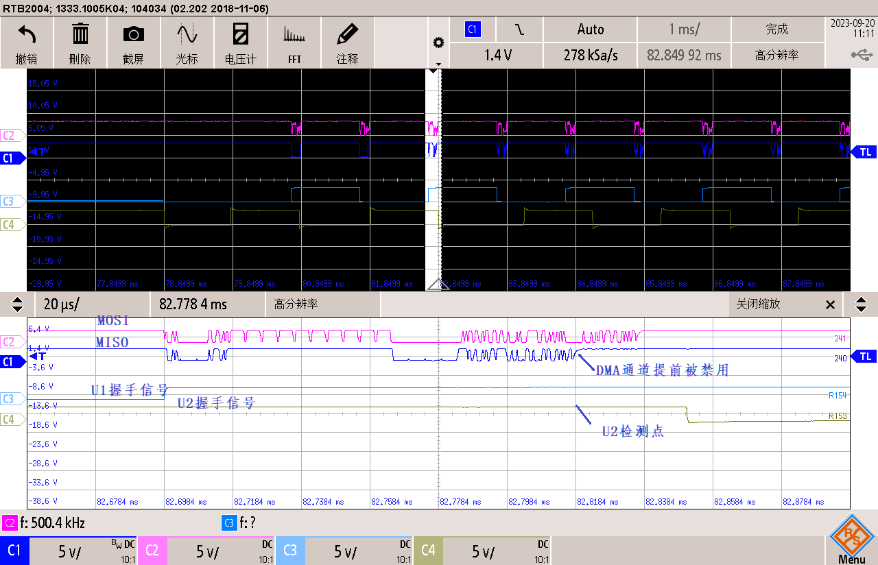

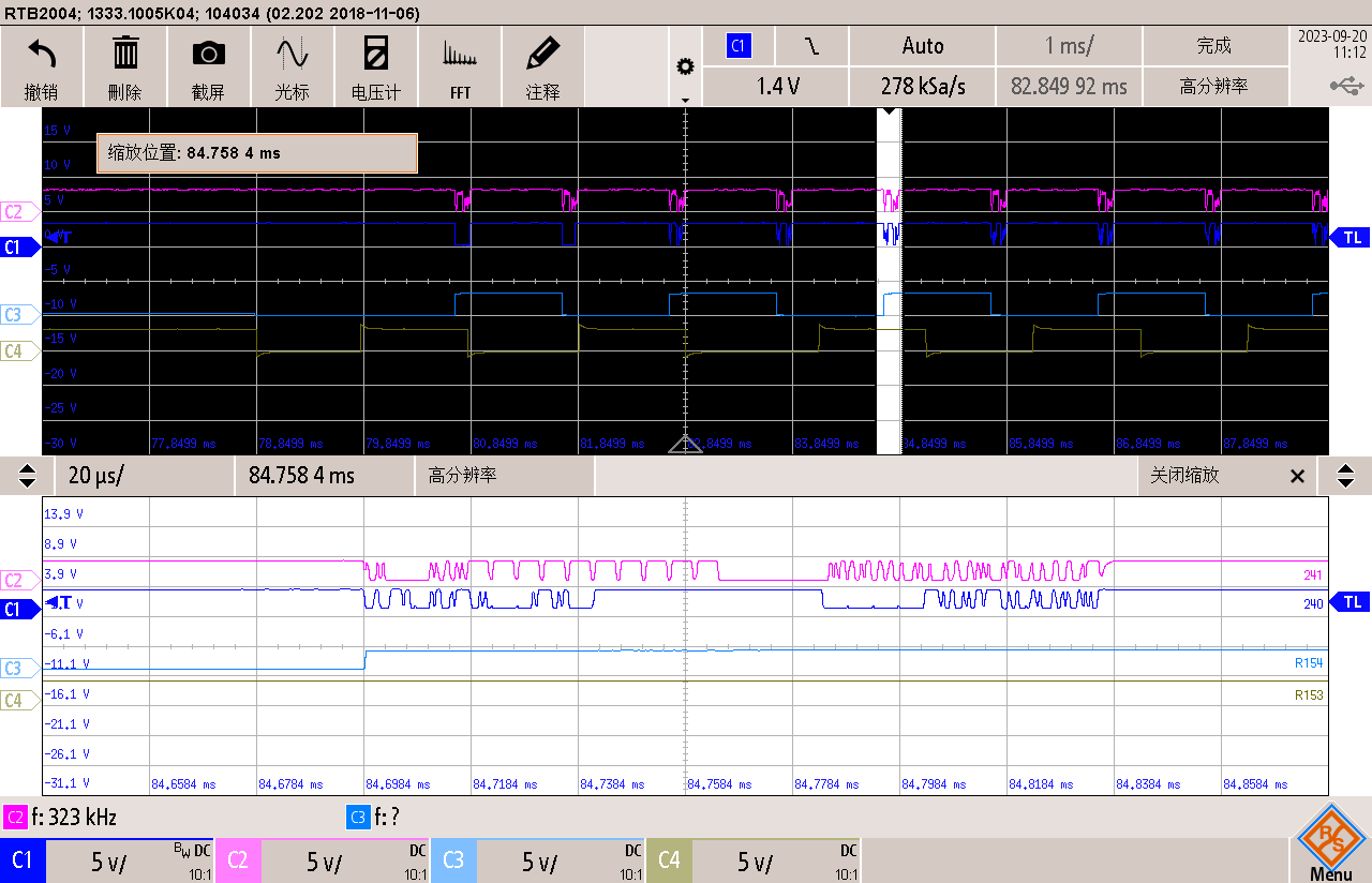

    C2=MOSI
    C1=MISO
    C3 = sync up signal for master SPI ,when the master finish the DMA TX transfer , flip the C3 voltage level.(But slave SPI with not handle this signal)
    C4= the Slave master will detect the RX DMA status and follow below procedure:(target to make sure the slave SPI RX & TX DMA is done, then means the RX already receive all the data.)
    uDMADisable();
    //The time from detection to execution is 50us
    //flip the C4 voltage level
    when the master SPI detect the C4 signal inversion with edge triggering, the master SPI will start enable DMA to send data. When it is done , flip the C3 voltage level, such a cycle.
    So base on above external pin for Sync logic , customer can reach the Point to point Full duplex TX/RX.
    But customer found some random issue is that the slave DMA will disable in advance when the MOSI still transmitting.
    For normal case ,all the signal have been fully accepted。

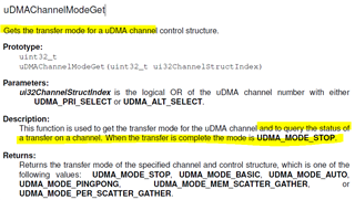

    Can you try DMAChannelModeGet() to determine if the transfer is complete? Does it make a difference?
    Below is an example to use SSI0. You may have used a different SSI module.
     if (DMAChannelModeGet(UDMA_CHANNEL_SSI0RX | UDMA_PRI_SELECT) == UDMA_MODE_STOP)
    uDMADisable();

     For system level ,what s the major difference of the DMAChannelModeGet()  and uDMAChannelIsEnabled()
     As i see, when the transfer is complete,  the DMAChannelModeGet mode is UDMA_MODE_STOP .
     For uDMAChannelIsEnabled() ,it checks to see if a specific uDMA channel is enabled, when the transfer is complete,the channel is automatically disabled, so false status can be checked.
     So as i see ,they both suitable to detect the DMA status, is there anything i miss?
     tks for your comments.
      When you use uDMAChannelIsEnabled to determine the status of the channel, it is possible that the channel is disabled before the data is actually transferred completely. For example, let's say you have a total of 100 bytes to transfer and you have 4 bytes remaining to transfer. Since uDMA knows that these 4 bytes are the last 4 bytes, it may have disabled the channel as soon as it starts to transfer these bytes. However, the transfer actually will take some cycles to complete. This may be the reason that you see that the value in  uDMAChannelIsEnabled indicates it has finished but the transfer is still going on. I hope that by using UDMA_MODE_STOP, it actually waits until the transfer is completely done before updating the channel status.
