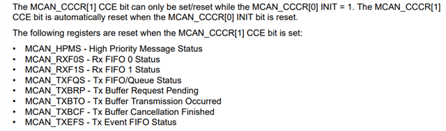

After I get CAN Tx complete interrupt I read MCAN_getTxBufTransmissionStatus to understand which buffer was sent ( tx complete ).
But each next interrupt I get I see that previous Tx Complete bit was not cleared. So I get:
 - 1st interrupt - status =  0b0001 ( OK here )
 - 2nd interrupt - status = 0b0011  ( assume to get 0b0010 )
 - 3rd interrupt - status =  0b0111  ( assume to get 0b0100 )
Please advise how to clear TXBTO status bits ?  -  register is read only, no API exist
