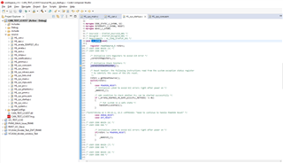

  • Hi Ajith Kumar,
    2. The boot code will execute from the flash.(which was predefined by the manufacturer)
    There won't be any predefined code from manufacturer. After controller out of the reset it will directly starts executes the code from 0x0 address of the flash.
    So, there won't be any primary bootloader concept here. So, all the initializations will be the part of the application code only. I mean all the necessary initializations like CPU registers initializations, stack pointer initializations, memory initializations and system initializations everything will be stored in flash only. And these all initializations will be located in the function "_c_int00".
    After processor come out of the reset it will directly execute these initializations by branching to the function "_c_int00".

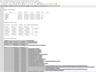

    2.Is the Boot code can be modified by user. Is it possible and how?
    The code will always start executing from the flash address 0x0, it's all depending on the type of code we programmed at the starting of the flash.
    In general, HALCoGen will generate code like below:
    On starting address, it will store the interrupt vectors and then it will store the different object files of the code one by one.
    So, after reset the processor will execute the code vector table located in address 0x0 and it will jump to the _c_int00 function.
    So, you can modify this code as per your requirements.

    4.Difference between boot code and startup code?
    As i mentioned earlier there won't be any boot code from manufacturer. All the initializations in the _c_int00 function till it is calling main function could be called as a startup code.
