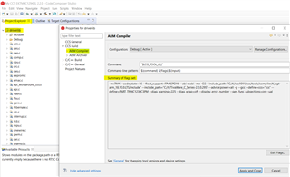

    The Tiva lib was build with wchar_t=16. If I switch globaly to wchar_t=16 than the error occurs that libc is build with wchar_t=32. Can I rebuild the Tiva Lib? Is wchar_t used by the tiva lib at all? So maybe I can ignore it. Its a C only lib so there is no wchar_t isn`t it? Can I than suppress the warning for specific includes?
    I do not see wchar_t being used for Tiva driverlib.
    You can rebuild the drivelib. You can import the driverlib project from the TivaWare SDK into CCS and rebuild it.
