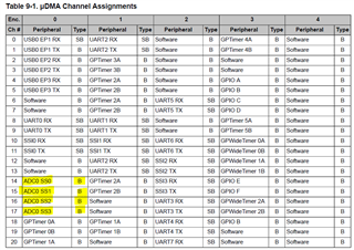

I looked at the example adc_udma_pingpong and have questions about it:
1. why do I need to enable burst mode on a channel with a sequence? Or in other words, what advantages does this give me?
// Set the USEBURST attribute for the uDMA ADC0 channel.  This will force
// the controller to always use a burst when transferring data from the
// TX buffer to the UART.  This is somewhat more efficient bus usage than
// the default which allows single or burst transfers.
uDMAChannelAttributeEnable(UDMA_CHANNEL_ADC0, UDMA_ATTR_USEBURST);

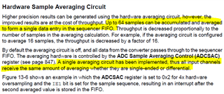

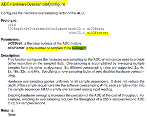

3. on page 807 in the data sheet it is about hardware sample averaging. This 4 cell FiFo is also shown there. 4 samples are combined and divided by the number of samples. I am still unsure with which sample rate an averaged sample was sampled. I have the function; ADCClockConfigSet() and about ADCSequenceConfigure() I can set a timer with a fixed frequency. I think I need an example.

    First of all, you can only use burst for ADC transfer. Please see below. As you know there is a FIFO associated with a Sample Sequencer, a burst would allow uDMA to read all the available data in the FIFO in one shot instead of reading each data as an individual uDMA transaction. Take SS0 for example, the depth of the FIFO is 8. Why wouldn't you want to read all eight data at once. This is the advantage compared to reading in 8 different uDMA transactions.

    I'm not sure if your understanding is correct. Hardware Averaging is not to take samples of 4 channels and take the average of it. Of course, you could do too. Let's say you use SS1 where 4 channels can be sampled. On your board, you could route your analog ADC input to all 4 channels. In another word, all 4 channels are taking samples of the same input. Your application can do the averaging but that is a software approach of averaging. The ADC module has a hardware Sample Averaging Circuit. This is a hardware averaging.  Let's say for example you are using SS3. This sample sequencer can only take one sample on one input channel. You could still enable hardware averaging. For example, if the averaging circuit is configured to average 16 samples, the throughput is decreased by a factor of 16. In another word, the input will be taken 16 samples before the final average is moved to the FIFO. If an interrupt is enabled, the interrupt is not generated until 16 samples have been taken.
