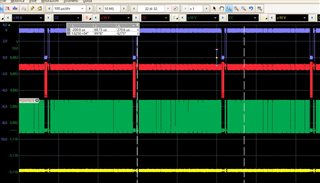

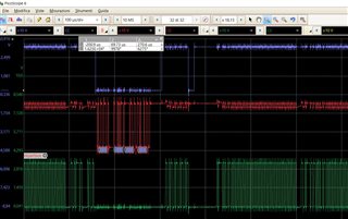

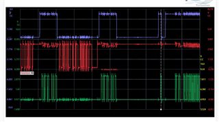

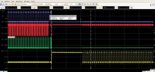

    Blu is TX-EN, Red is Data-In, Green is Dataout of CH0,
    Yellow is TX-EN of CH1.  You see as soon PRU0 is starting CH0 will Stop. May because of the REINIT_TX in datalink_init ??
    It is global to all channels as far as I could understand from the TRM, but may be I'm wrong. May in load share mode it is refreed only to one channel ???

  • Hi
    Are you starting CH1 after CH0 with some delay in between them?
    You are correct. REINIT_TX is global, even in load share mode.

    I commented out the REINIT_TX and both channels are working except for the restart on channel 0.
    Not 100% good, but much better. I'm running in 300Mhz free-run and Multi channel without any modification on the original source code except for the initial reinit_tx comented out.
