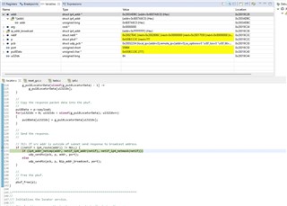

As we are in the process of upgrading sensors at off-shore wind turbine sites, a very costly process, we would like to have the findings in that old threat confirmed ?
      I don't think it was conclusive in the finding reported by the poster in the post you reference. As Amit (who is no longer with TM4C support) mentioned in the post, there is no issue with the link status during plug and unplug when running a stock TivaWare Ethernet example. Do you see the same issue as the referenced post? Did the workaround in that post solve the problem? As far as I tell, tivaif_process_phy_interrupt() in the latest TivaWare version has added support for EEE mode. Otherwise, it is much the same as the one pasted in that post. In the ISR, it first checks if there is a change to the LINK bit in the MISR1 register. If yes, check for whether the LINK bit is high or low in the STS register before passing the corresponding link info to the lwip stack.

  • We are not in doubt that we have this as a major issue with our clients. The mentioned fix made the unplug/plug situation work well. We just want a confirmation that we now use the fix correct.
  • Hi Peter,
     Thank you for confirming your observation as this finding is new to me. I'm also glad that the workaround resolves your issue. I will bookmark this post for future reference. The current code is reading the STS register bit 0 for LINK status. Reading the datasheet, it has a note saying "This bit is not cleared upon a read of the EPHSTS register". I'm not fully sure what this means. I wonder when the NIC is unplugged, this bit remains sticky and not change. Hence, the workaround by the poster in that reference post forces to read the BMSR register to refresh the sticky bit.
  • I agree with your thinking and reading of the register descriptions. I have to add that seldom the old code works, maybe one out of 20 times. We actually tried to make Wireshark comparisons of the activities when succes/no succes, but nothing could give further explanation.
    By setting breakpoints at the link-up and link-down actions, it is seen that the change of link flag, when attaching the wire, works correct leading to the evaluation of up or down, but ends down !
    It seems that the internal state is corrupted during the removal of the wire.
    Problem now is simply if the solution is reliable and correct ?
