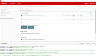

  • In Uniflash neseccary pages is selected.https://e2e.ti.com/resized-image/__size/320x240/__key/communityserver-components-multipleuploadfilemanager/fdcc57ab_2D00_368c_2D00_4901_2D00_acUpload 4f_2D00_1d5315c77c50-577940-complete/necessarypage.png
    boot address selected as 0x00 while loading , app address selected as 0x4000 while loading,
    memory after upgrade via uniflash: both are having data,
    App base in code also 0x4000. Verification also passed  .
    Code is not running and tried reset also.
