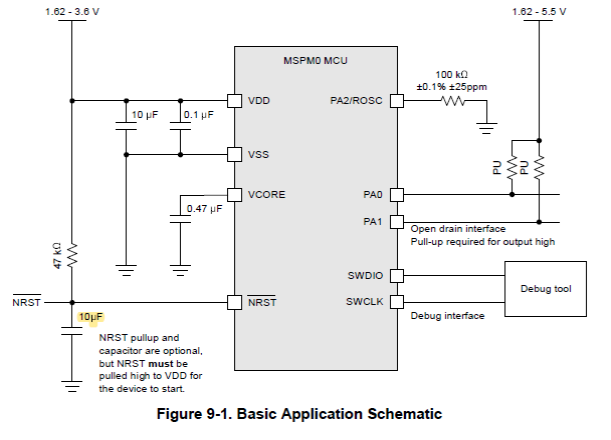

Part Number: MSPM0L1306
Hi champs!
There is a discrepancy between text and picture (10nF vs 10uF)!
Can you please check ?
BR Dirk

Hi Dirk,
Turns out, unlike MSP430, the value doesn't really matter. The 10uF is a suggested value to keep noise from causing false resets. Minimum recommended is 1nF.
Also, the NRST pin is not used by a programmer/debugger (only SWDIO, SWCLK), so no concern from that perspective.
