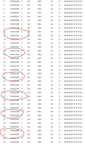

Hi Team,
The program calls the RTI for timing, the timer is set to 100ms, then the flag bit is set in the interrupt function, and the flag bit is detected in the background while loop. If the condition is true, send one CAN data out. The time has increased significantly after 5 to 6 can frames.

The data received through the CAN receive tool is as follow, the time stamp in the red box has a significant increase, around 20ms:
Could you help check this case? Thanks.

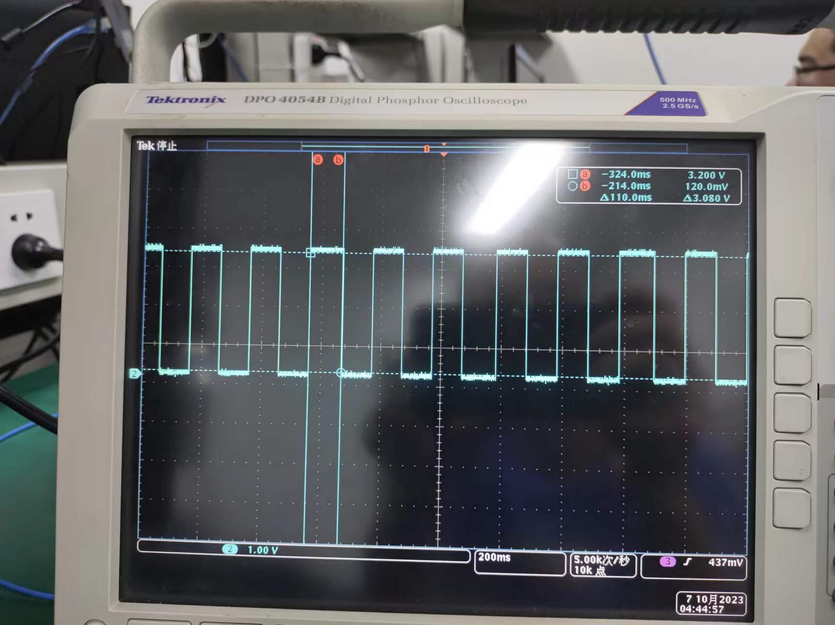

  • Hi Jagadish,
    Thank you for the support.
    Modify the program to change GPIOs in RTI interrupts, set RTI to 1ms, and change the GPIO state every 100ms. It can be seen that the time interval for this phenomenon is not fixed.

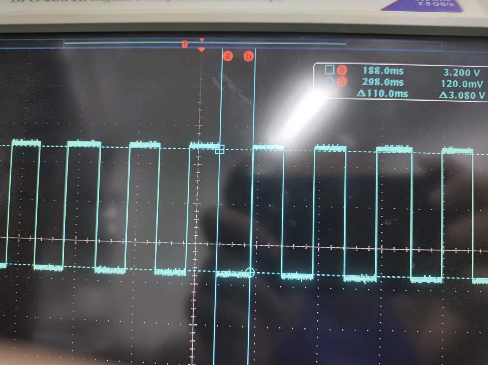

    The captures of oscilloscope are as follows, the interval is not very accurate, there is 110ms and some are 100ms:

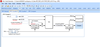

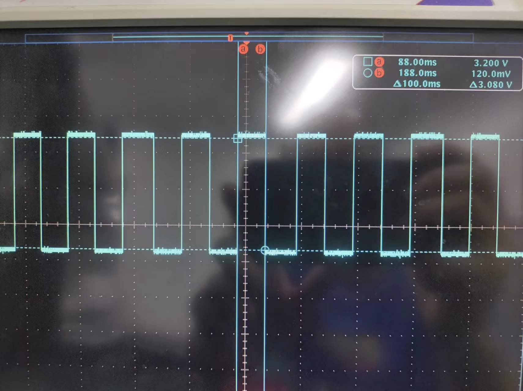

  • Hi Cherry,

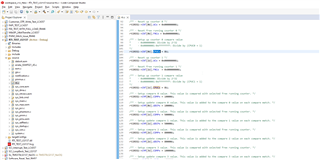

    I just tested customer code on my LS3137 HDK board:
    And i didn't see the issue customer talking about:
    I can see toggling for every 100ms only.
    I am attaching my project and tested waveform for your reference.

  • Hi Jagadish,
    The development environment is Keil5.25, which integrates the Legacy package and uses HALCoGen to generate call code. And please see the test demo: https://e2echina.ti.com/cfs-file/__key/communityserver-discussions-components-files/96/TestRTI.zip
    In this test code, the measured waveform has a deviation.

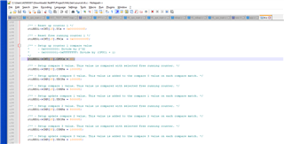

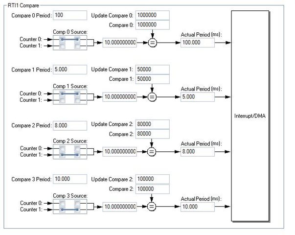

  • Hi Cherry,
    I just verified the customer code with my code, the only discrepancy i saw with the customer code is "CPUCx" values for counter-0 and counter-1
    In customer code it is 4
    And in my code it is 8
    I know this value is just depends on the RTICLK we are using, and counter frequency required, like as below in my case:
    I don't see any other discrepancy, so can you ask customer to modify this setting as per my settings?
    Thanks & regards,
