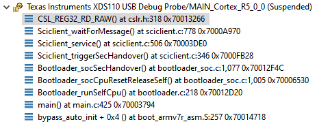

We recently re-spun a custom board with the AM2431A microcontroller to now use the AM2431B microcontroller.  On the previous board, we successfully converted the sbl_sd example into an eMMC SBL that read and booted a multicore appimage file that was flashed to the eMMC boot partition.
When the new board arrived with AM2431B microcontroller, we updated the SDK to version 09_00_00_30 since we had to support HS_FS operation.  We have gone through the migration guides multiple times and were finally able to get the SBL and Application properly built and signed, We have now run into an issue where the SBL appears to validate and load the the multicore image, however, it never seems to get past the Bootloader_runSelfCpu() function once it is ready to start the application.
When debugging the SBL in CCS, I paused and looked at the call stack once the SBL appeared to be hung.  Here's what it showed:
It appears that the Security handover never completes successfully, as a response is never received when the TISCI_MSG_SEC_HANDOVER message is sent.

    As I mentioned in my original post and showed in the call stack image, on our new custom board with the AM2431B, everything in the process works properly until the SBL tries to start the R5 image.  It gets stuck waiting for a response to the TISCI_MSG_SEC_HANDOVER message.
  • I decided to tried an even simpler example to see if I could get this to work.  I built the hello_world_am243x-evm_r5fss0-0_nortos_ti-arm-clang example and then flashed it to address 0x80000 in the eMMC with the uart_uniflash.py script.  I also modified my eMMC SBL to simply start up, read the image from location 0x80000, load it into the R5 and then start the R5.
    Unfortunately, it still gets stuck at the same place, waiting for a response to the TISCI_MSG_SEC_HANDOVER message.  We're now wondering if this issue has to do the M3 not resetting properly when it is time to start the R5.  Any thoughts on this theory?

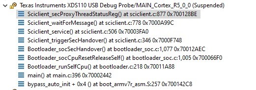

    When I pause CCS and look at the stack dump, this is what I see (same as posted earlier in this thread):
  • Checking in to see if there are any more thoughts on this. We found that we have the exact same issue with the same stack dump shown above if we have an Application running and it calls  Bootloader_socCpuResetReleaseSelf() to restart itself.
