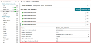

    The MPU settings for the same are also mentioned here -
    Hope it helps.

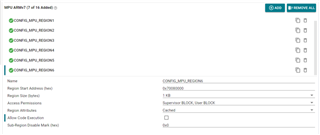

  • Hi Aakash,
    I tried the above example but it seems to fail. Please let me know what I have been doing wrong here.

    MpuP_RegionConfig localMpuRegionConfig = {
                                          .baseAddr = 0x70080000,
                                          .size = MpuP_RegionSize_1K,
                                          .attrs = {
                                              .isEnable = 1,
                                              .isCacheable = 1,
                                              .isBufferable = 0,
                                              .isSharable = 1,
                                              .isExecuteNever = 1,
                                              .tex = 0,
                                              .accessPerm = MpuP_AP_ALL_BLOCK,
                                              .subregionDisableMask = 0x0u
    uint8_t secure_variable[1024] __attribute__((section(".data.secure_variable"))) = {0x01, 0x02, 0x03, 0x04, 0x04, 0x05, 0x06, 0x07, 0x08, 0x09, 0x0A, 0x0B, 0x0C, 0x0D, 0x0E, 0x0F};
    void access_permission_set(uint16_t perm)
        /* Disable MPU */
        localMpuRegionConfig.attrs.isEnable = 0;
        localMpuRegionConfig.attrs.isCacheable = 0;
        MpuP_setRegion(6, (void *)localMpuRegionConfig.baseAddr, localMpuRegionConfig.size, (MpuP_RegionAttrs *)&localMpuRegionConfig.attrs);
        /* Change the Access Permission */
        localMpuRegionConfig.attrs.accessPerm = (uint8_t)perm;
        /* Enable MPU */

    MPU config in syscfg
    Output on uart terminal:
    Function b and c should have triggered an abort but neither does.

  • Hi ,
    Can you share your map file ? Is your .data.secure_variable aligned to 1K memory ? MPU only aligns the memory to the size of the region so the .data.secure_variable should be at 0x70080000.
    If the above one is okay then, can you read out the CPR15 registers in the debugger to share more information ? Also please do this experiment after each access_permission_set call done in Function B/C ?
    Aakash
  • Hi Aakash,
    Thank you, I had forgotten to change the name of the section in the code where I'm assigning the secure_variable.
    Now the example works.
    Thank you for your support.
