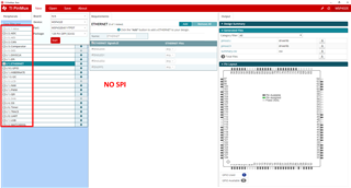

1-) The MSP432E401 does not have an SD interface?
2-) Does the MSP432E401 have an SPI interface that allows me to use the micro SD? I am confused about this because some information shows the MSP432E401 with SPI interface and other times it does not, Please see the attached images.
3-) At firmware level are there pettitfs libraries or similar to handle (in an easy way) the micro SD with SPI?
Thanks very much!

     Just to add on top of what Jim has provided.
    No, MSP432E does not have a dedicated SD interface.
    It is called QSSI in MSP432E where it can operate as a legacy SPI module.
    This example may help.
