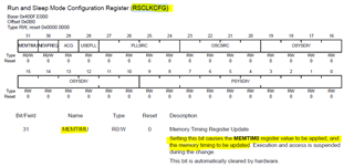

    At a glance, and not knowing too much about the MSP432E4, I would expect that the only thing I might need to do differently than the poster would be to manually configure MEMTIM0 (MSP432E4 TRM, Section 7.2.3.1) appropriately for a 48 MHz frequency? It would seem that, because the same MEMTIM0 register settings can be used for 25 MHz and 30.72 MHz, one can get away without configuring MEMTIM0 if using a single-ended clock at 30.72 MHz.
      That is a very good point. Yes, for frequency of 48Mhz, you would need to manually adjust the MEMTIM0 register for the flash wait states according to the table. You will need to also set the MEMTIMU bit in the RSCLKCFG register for the MEMTIM0 to be applied.
