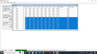

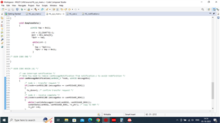

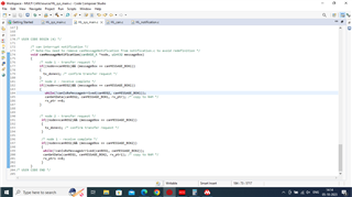

i written a code for CAN tx and rx communication but im receiving the sending data but in a revers form so can u help me with it what im doing wrong in code or halcogen
here my code is:
hell sir
here my code is:

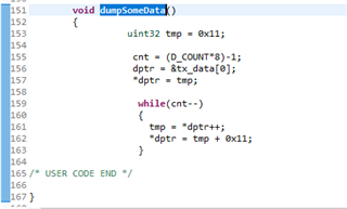

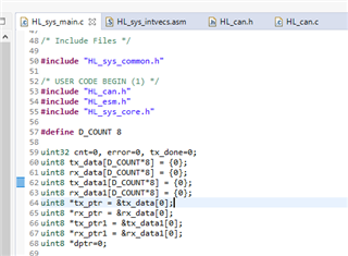

One mistake is below:
You are declaring tx_data buffer as just 8 characters size right?
But in dumpSomeData function you are just trying to move 64 charactters?
This is just array overflow condition right? So please correct this mistake?

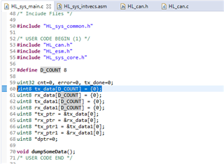

is there any other mistake im doing in this code or do i have to change any configuration in halcogen
Hi Jeev,
My suggestion is first try to increase the buffer sizes like as shown below and test it and let me know the results?
