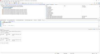

    I have modified the mcspi_loopback_dma_am263x-cc_r5fss0-0_nortos_ti-arm-clang in MCU+ SDK 09.00.00.0033 with CCS 12.4.0 to add the MCSPI1 DMA loopback. Here is the execution result:
