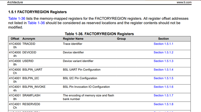

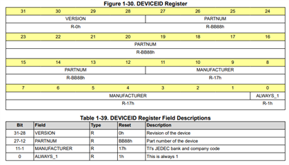

Hi Team,
There's an issue from the customer need your help:
I've read the picture following like this, but after trying a few chips, the data read out is the same.
what's going on?

Hi Ben,
Sorry for the late response. Looking the DEVICEID register, all MSPM0L1306 will have same REV, PARTNUM and MANUFACTURER. The only field that will change over time is if there is a silicon spin from say revA to revB. Otherwise, all other fields will be the same from part to part.
Does this help, or am I still not understanding what the customer is asking?
