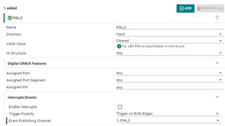

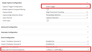

  • Hi Jost,
    See the configuration below (please modify according your requirements):
    The screenshot is the configuration of the timer and gpio.
    You can use the code example in SDK: timx_timer_mode_capture_duty_and_period_LP_MSPM0L1306_nortos_ticlang, and then configure a gpio input and timer capture mode according to the picture.
    Is your suggested solution to get a GPIO-interrupt for PA13 in which the further processing of the captured timer value is done?
    The function is that you can read the capture period value in timer interrupt, while you can also read the gpio pin polarity anytime.
